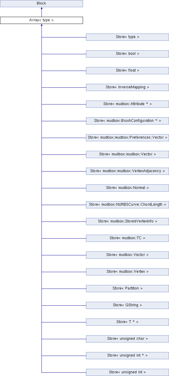

Class Description
template<typename type>
class mudbox::Array< type >
An internal helper class, representing an array. Use the Store class instead.
Definition at line 65 of file array.h.
+ Inheritance diagram for Array< type >:
