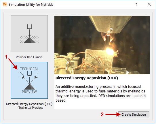

  2. In the dialog that opens, click Directed Energy Deposition, and then Create Simulation.

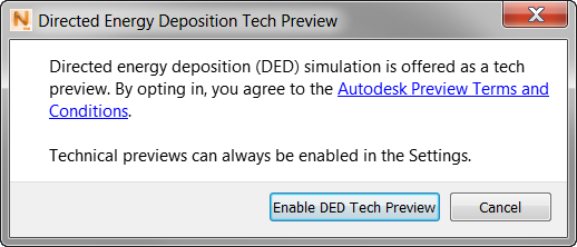

    If you have not opted in to the DED technical preview, you will be offered the opportunity to do so.
    More information is available at Simulation menu > Settings > Preview tab.

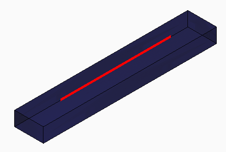

  6. Still in the Build Plate dialog, click the Size tab, and set three Length values as follows:
    • X Length: 60 mm
    • Y Length: 10 mm
    • Z Length: 5 mm
    Resulting model and build plate

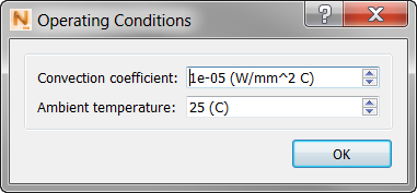

  8. Click Operating Conditions, set the Convection coefficient to 1e-05, as shown below, and click OK.

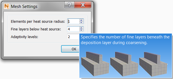

  9. Click Mesh Settings, and set the values shown below.
    Note that each setting here has an illustrated tooltip:
    • Elements per Heat Source Radius controls the mesh density.
    • Fine Layers Below Heat Source sets the number of layers that are kept fine, and not adapted below the heat source.
    • Adaptivity Levels specifies the maximum number of coarsening generations in the mesh.

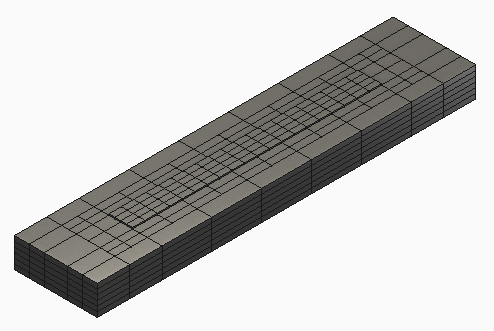

  10. Click OK to close the Mesh Settings dialog, then click Mesh Preview and save the project in a suitable location. Load the mesh when it's available, and inspect it.

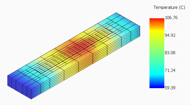

  13. When the results load, click the light bulb to turn on the Temperature results.
  14. On the Results tab, open Plot Settings, set the Displacement Scale to 10 to magnify the displacement results, and click OK.
    Play through the results, remembering that the near end of the build plate is fixed. We see the far end of the build plate deflect upwards.
    We can follow the deposition passes and see that toward the end, slightly higher temperatures remain in the part, causing the upward deflection of the build plate.

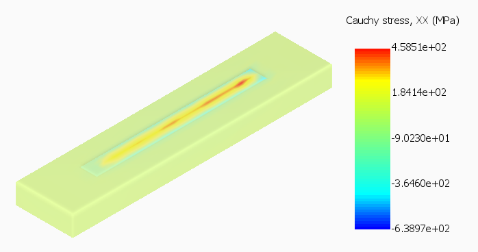

  15. Turn on Cauchy stress results to verify the presence of some stress at the end of the build. On the Results tab, click Plot Settings, and in the dialog, ensure that the Component value is XX and the Range is set to Global. Click OK.
    The figure above shows stress levels at the end of the build. For better visibility, element edges were turned off in the Browser by right-clicking Cauchy stress > Render Properties and deselecting Element Edges.
