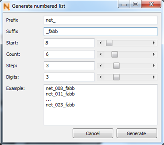

To generate a list
If you do not have a CSV file containing a list of labels, you can create your own list.
  1. In the context view, click Generate List.
  2. Make adjustments to the list generation fields, if necessary.
  3. Click Generate to create the list.
Prefix
Text that appears at the beginning of each label
Suffix
Text that appears at the end of each label
Start
Offsets the numerical list to this value
Count
How many list items to generate
Step
The numerical increment between list item
Digits
The number of digits to use for the numerical part. The value is padded with leading zeros if necessary.
Example
Shows a preview of the list to be generated

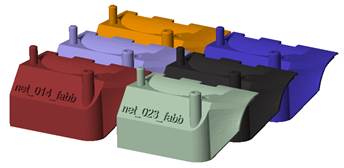

An example for setting up a list generation
The labeled parts as generated using the example.
