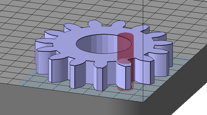

To help with aligning and packing parts on platforms, some machine model definitions include no-build zones which are displayed and checked against: If a part intersects with such a zone, a warning is given upon attempting to generate build or simulation data.
A part intersecting with a no-build zone (in transparent red) will produce a warning message.
