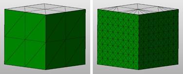

Increase triangle count by subdividing existing triangles
During a mesh refinement, the existing triangles are split into smaller triangles until all triangles have at most the specified edge length. The shape of the part is not changed by this operation. A refined mesh can produce better results for smoothing, for example.
A mesh refinement has been applied to the selected surfaces of this cube.
