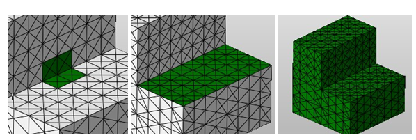

Select Triangles: Selects individual triangles.
Select Surfaces: Selects consecutive triangles until they are angled further than a configurable threshold away from the previous one.
Brush Selection: Selects individual triangles by painting over them with a brush.
Select Shells: Selects entire shells.
Left: Selected triangles. Center: A selected surface. Right: A selected shell.

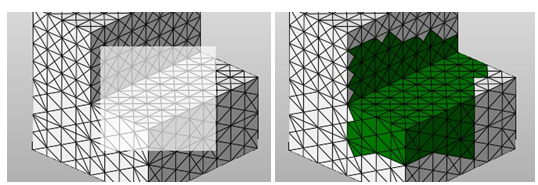

Selection Primitive. Available options include:
Left: Drag a primitive shape. Right: The resulting selection.

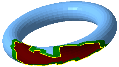

If you have a part that contains a hole, some actions benefit from, or even require, selecting one or more of the triangles directly touching the hole.
Select all Surrounding Triangles to select every triangle touching the hole.
Select Attached Triangle only to select the triangle adjacent to the edge.
In preparation for freeform-hole closing, the triangles surrounding the hole have been selected.
