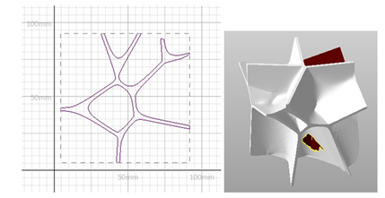

The display occupies the largest section of the user interface. It provides the 3D visualization of a project, including parts and the platform. The style of visualisation adjusts when the currently performed task requires it, such as when making repairs.
The display is also used to show slice contours and hatches.
Left: The two-dimensional view on the slice of a part in the slice commander. Right: A part in the repair module.

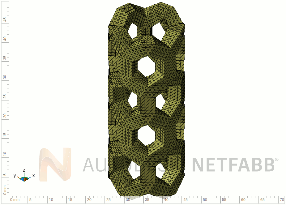

Rulers
Rulers provide a visual cue as to the current scale of the display. They are scaled dynamically with the zoom. Netfabb provides two rulers, a horizontal one at the bottom, and a vertical one along the left, and using the options Settings > Settings > Display > Ruler, you can configure their color and visibility, and also toggle the vertical one of the rulers.
As you zoom, the rulers adapt to illustrate the display scale.

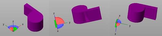

Perspective indicator
To give an indication of the viewing angle relative to the build platform (read: the global coordinate system), a representation of the coordinate system is available in the bottom-left corner. It shows the three cardinal axes as well as the three planes formed between them. To help recognizing the orientation, not only are they colored the same as the axis that stands vertically upon them (X axis - YZ plane - blue, Y axis - XZ plane - orange, Z axis - XY plane - green), they are also adjusted in size. The further the planes are away from the camera, the bigger they are drawn.
Tip: Click the planes to orient the view such that the respective plane becomes parallel to the display.
Three different perspectives and the perspective indicator in the matching orientation.
The perspective indicator can be adjusted in its appearance using the options at Settings > Settings > Display > Coordinate system.
