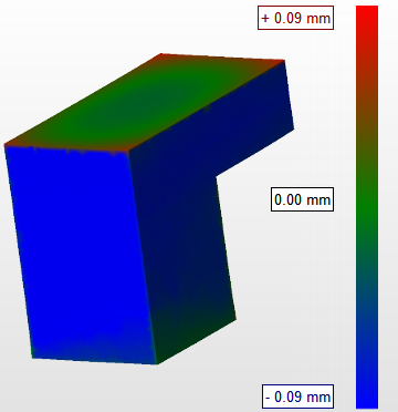

Compare two meshes takes two meshes and compares them based on their meshes' nodes. The results are visualized in a color gradient, and can also be probed in individual locations to receive a numerical readout.
While this allows comparing widely different parts at completely unrelated locations and orientations, this function is best used to learn about the before-and-after of particular processing steps such as remeshing, scaling,
To compare two meshes, Netfabb employs a module.
Comparison of original part and the simulated result of its print.
This tool is well suited to compare before-and-after versions of the same part to learn where, and by how much, the shape has changed by actions such as repairing, remeshing, extrusion, and scaling, as well as deforming and corrective warping derived using Autodesk® Simulation Utility for Netfabb®.
