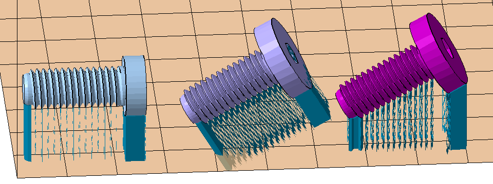

Starting on the default platform with a part that has support already generated and attached as parametric support (in blue),
Three stages of rerunning support actions: Original, rotated and extruded part, reapplied supports.
