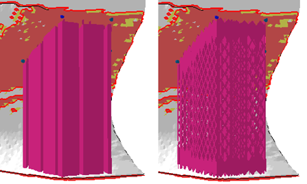

Filling Type
Switch the support walls between Hollow (solid) and Structured.

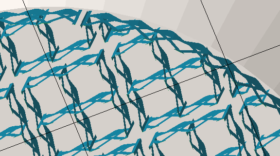

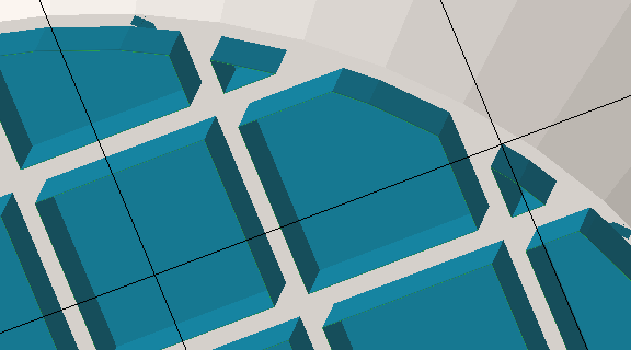

  • The fragments that make up hollow supports are essentially box-shaped columns. They are closed on all sides, even at top and bottom. The connection with the part surface is facilitated by small pins.
  • Structured supports are, by default, akin to patches of intersecting wire fence. Also, the entire cluster area is enclosed by a single wall along the circumference, ie. the cluster's contour.
Applied default hollow supports. A cut via clip plane demonstrates the cluster's contour, the fragments' cross section, the terminating surface at the top, and the stand-off against the part surface.
Applied default Structured supports. Note the gap in the circumference.

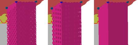

Structure pattern
Switch between Wired wall (left), a Punched plate (middle), and Solid (right) to determine the wall pattern of volume supports.

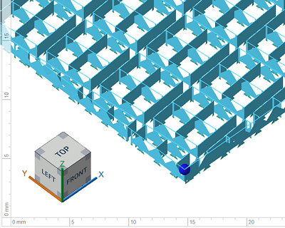

The raster is built up from intersecting polyline walls and fills the actual volume of volume support.
Rotate by Z
Sets the general alignment of filling structures. Filling structures are aligned globally, as in, against the platform coordinates.
