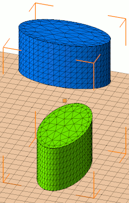

Connect two dissimilar meshes with a curved, closed mesh net
When connecting two shells with dissimilar cross sections, a smooth transition from one contour to the other is often desired. This method performs just this task.
Select all surrounding triangles from the context menu.
The six steps of connecting two dissimilar shell ends: Two separate shells, Repair entered, shell faces opened, triangles that include the holes selected, transition generated, change applied.
