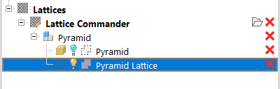

The
lattice is generated as a new body. The original mesh body is still there, but it has automatically been switched to be
invisible and
ignored.

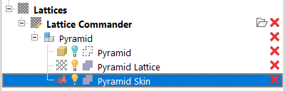

This function takes the original mesh body and assigns a thickness to each of its triangles.
The
skin has been generated.

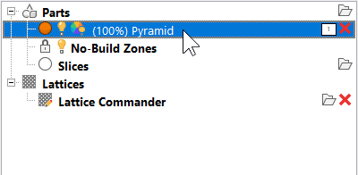

Parts are generated from the whole
component, and the result is sent to the platform that was selected last before starting the part generation. Generating parts rasterizes the entire component and compares the roles of all present parts to determine where the generated part should be solid.
Use the roles for each body in a component to determine the outcome of part generation,
solid,
trim,
void, and
ignore.
