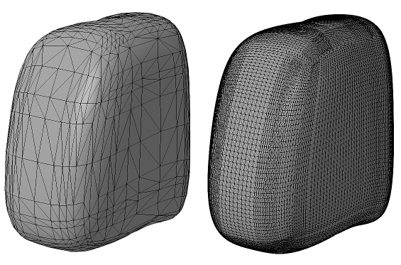

The same parametric part, tessellated with two different presets
Restriction: These tasks may require that the CAD part be without flaws that prevents it from later steps in print preparation such as slicing. If a part requires repair, even if it is just for removing duplicate shells, the tessellation must be made permanent by converting the parametric part to a mesh one.

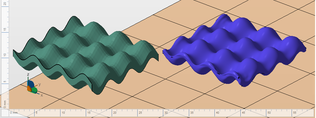

Making meshes parametric
Netfabb can generate a parametric model from a mesh part by remeshing and converting it using the BREP approach. BREP stands for boundary representation.
The function surface from the part library as a mesh (left) and the parametric model generated from it.
