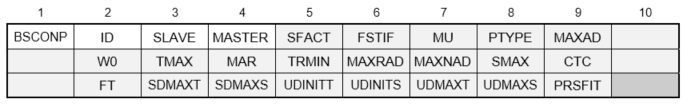

BSCONP
Surface Contact Parameters
Description: Defines the parameters for a surface contact region.
Format:
Example:
Field Definition Type Default
