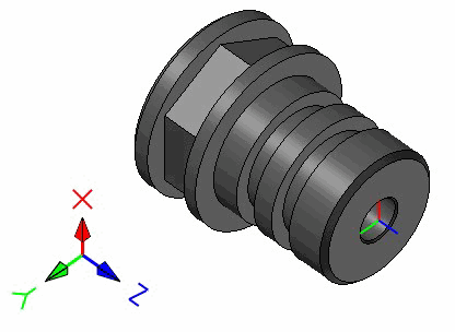

  1. Select File > Import > X_T Parasolid Text File to display the Import Parasolid X_T File dialog.
    In the Getting Started folder of your PartMaker installation, select the getting_started_inch.x_t file and click Open.
    PartMaker displays the solid model in the 3D area of the graphics window:

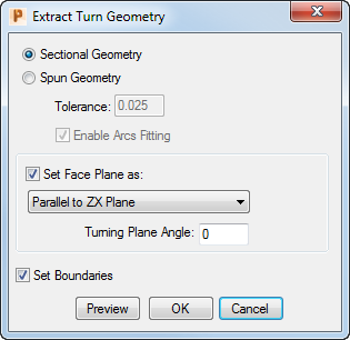

  2. Click the Extract Turn Geometry button on the Solids toolbar to display the Extract Turn Geometry dialog.
  3. Complete Extract Turn Geometry dialog as shown, then click OK.
