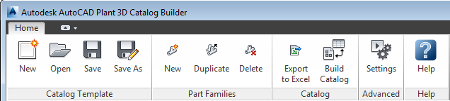

Catalog Builder Ribbon
Manages catalog template files and creates catalogs.
Catalog Template
Manages CTPL catalog template files.
Part Families
New
Adds a new part family to the catalog template.
Duplicate
Copies the selected part family to a new part family. You can select part families in the component tree view pane.
Delete
Removes the selected part family.
Catalog
Export to Excel
Creates a Microsoft Excel XLS file from the catalog template. You can specify detail for each component size (for example: parametric dimensions) using Excel.
Build Catalog
After you have added component size detail you can build a PCAT catalog file. After you specify an Excel file, the Build Catalog dialog box displays.
Advanced
Displays the Catalog Builder Settings dialog box.
