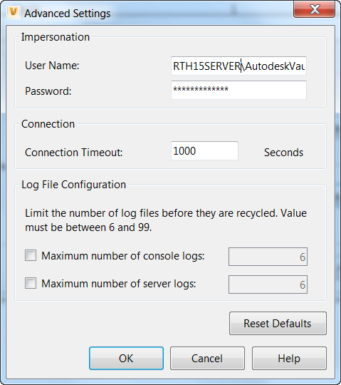

Configure impersonation account settings, the timeout threshold, and number of console and server logs to retain on the Advanced Settings dialog in the Autodesk Vault Filer Server Console.
Access Advanced Server Settings
- Select Tools
Administration.
- In the Settings dialog box, click the Advanced configuration Settings button.
Impersonation
- Enter the user name for the impersonation account.
- Enter the password for the user account. The user name and password that are entered must be a pre-existing local Microsoft Windows user or domain user.
Connection
- If the connection between a Vault client and the Autodesk Vault Server is timing out before large files can be transferred, you can increase the connection time-out limit. The default is 1,000 seconds. Enter a new time-out value.
Log File Configuration
You can configure the number of console, server, and email logs retained on the Vault server. The minimum and default value is 6 logs. The maximum number of logs per type is 99.
Reset Defaults
To return the values on the Advanced Settings dialog back to the default values, click Reset Defaults.
