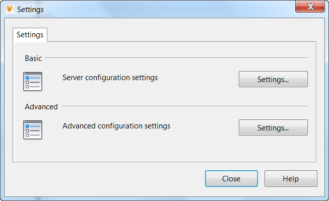

Configure server credentials and additional server settings, such as an impersonation account, the timeout threshold, and number of console and server logs to retain by accessing the Settings dialog.
Access Basic Server Settings
The File Server must be able to access the machine where the Autodesk Data Management Server is installed. Configure these access credentials in Basic Settings.
 Administration. Access Advanced Server Settings
Configure impersonation, timeout thresholds, and log retention limits in Advanced Settings.
