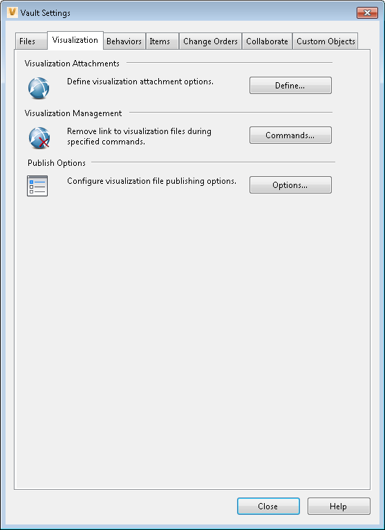

The Visualization tab on the Vault Settings dialog contains options for configuring visualization attachments, managing visualization files, and configuring publishing settings.
Access the Visualization Tab on the Vault Settings Dialog
Administration
Vault Settings.
Visualization Attachments
Click Define to enable or disable file attachments, specify where visualization attachments are published, and disable or enable the DWF warnings.
Visualization Management
Click Commands to specify which commands break the link between a data file in the vault and its corresponding visualization file.
Publish Options
