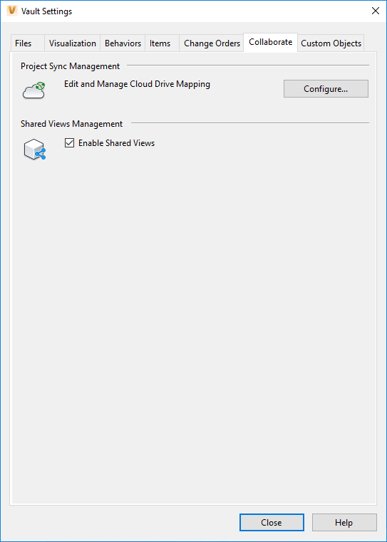

Administrators can enable, disable, and manage Shared Views and Project Sync.
Access the Collaborate tab.
Configure file syncing between Vault and Autodesk cloud drives. With Project Sync you can:
Manual sync lets you upload content to a cloud drive or download content from a cloud drive on demand.
Use Shared Views to collaborate on a visual representation of your model or design online. For example, create a shared view for a customer to request approval or to provide easy access to your field sales team for on-site presentations.
Refer to About Shared Views for more information.
