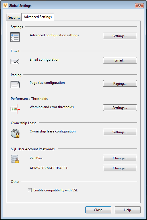

Fine tune your Vault Server performance and configure additional server settings, such as e-mail notifications and number of rows displayed on a page, on the Administration tab of the Global Settings dialog in the Autodesk Data Management Server Console.
Access Advanced Settings for the Vault Server
Feature |
Description |
Advanced configuration settings |
Configure the following advanced settings:
Email configuration |
Identify email recipients and send test email messages. |
Page size configuration |
Configure how rows of data are displayed on a page. |
Warning and error thresholds |
Configure performance thresholds. |
Ownership lease configuration |
Determine the length of time for which a workgroup has ownership of an object. |
SQL User Account Passwords |
Change the password for the VaultSys and ADMS_%SiteName% SQL Service Accounts. |
Enable compatibility with SSL |
If your SMTP Server uses SSL, you can enable Vault Server compatibility. |
