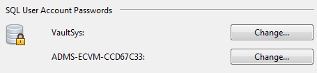

	 Change the Password for a SQL Service Account
- In the ADMS Console, select
- Select the Advanced Settings tab and click Change in the SQL User Account Passwords section next to the account for which you want to change the password.
-  On the Change Password dialog, enter the new password in both boxes.
- Click OK to save your changes.
