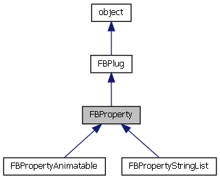

b>Property: Action Action property to trigger function. More...
