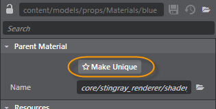

In the Asset Browser, navigate to select an existing material, or create a new one.
In the Property Editor, click Make Unique.
This creates a new parent material with a unique shader graph.
