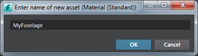

Right-click in your materials folder and select Create > Material (Standard).
Enter an appropriate name for the material and click OK.
This creates a new child material that points to the default, standard material. (The standard material is its parent.) The child material properties display in the Property Editor.
