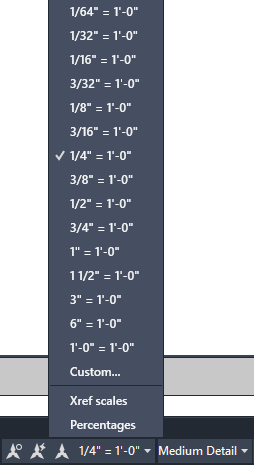

Specify the current annotation scale by selecting one from the Annotation Scale flyout menu.
