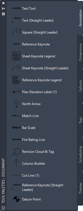

The annotation tools appear on the Annotation tab of the Document tool palette:

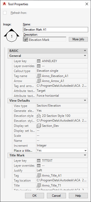

The specific type of annotation, its appearance, and other characteristics are determined by user-editable values on the Tool Properties worksheet, which is accessed from the context menu of the particular tool.
