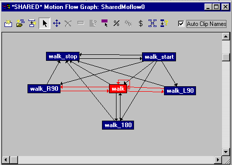

Biped's Motion Flow functionality provides the mechanism for defining how separate motions fit together into a fluid animation. In effect, the motion flow network describes which motions can follow from other motions. Once the motion flow network is defined, a broad set of animated actions is possible by following different paths through the network. In Biped, a path through the network is called a motion flow script.
For example, shown below is a motion flow network.
This is a fairly simple network of possible motions, because the characters can only start, stop, turn at 90 degree angles left and right (walk_L90 and walk_R90), and do an about-face (walk_180). However, for more natural crowd interaction, it's advisable to expand the motion flow network to include shorter, more finely tuned variations such as turning at 45 degree increments, moving in different directions while facing the same way, loitering motions, and moving at different speeds. The Biped Motion Library has a comprehensive list of clips for you to experiment with.
Motion flow graphs that work best incorporate fine-tuned transitions. A good way to check your motion-flow transitions is by building test scripts as you build the graph: Add clips to the graph, add the necessary transitions, and optimize the transitions. Optimizing transitions works well as a starting point and, more often than not, produces the smoothest transitions. Next, make a new script that uses your transitions, and use the script to tweak the motion flow until the feet don't slide.
The Shared Motion Flow Networks feature lets many bipeds use a single motion-flow network. Therefore, it’s practical to make motion-flow networks large without taxing your computer's memory.

Because bipeds in crowds are always following motion flow scripts, the avoidance behavior for bipeds works differently. Unlike ordinary delegates, biped delegates can move only along motion flow-scripted paths, so if a collision takes place, character studio will backtrack to the previous clip in the current script and find another path. This may take some time to compute when complex crowd interactions are present since a single backtrack may not be enough. The computation will explore all paths from a given backtracking clip, and if that fails, it will backtrack to the previous clip, and so on, until a solution is found.
In the example, if the current script of a biped is:
walk_start walk walk_L90
and a collision is encountered during the walk_L90 clip, the biped will backtrack to the end of the walk clip and attempt to try a different clip in place of the failed left turn. If that fails, it will try the next best choice, and so on.
