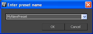

To create a custom preset
Save preset.

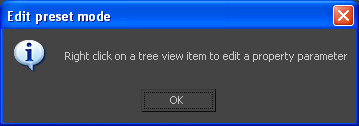

You can modify existing presets with custom option settings and UI layouts using the Edit preset mode.
Edit preset.

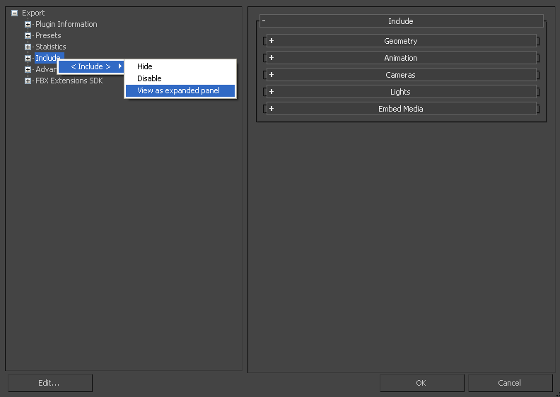

Use the Edit Mode options to customize your FBX UI preset.
This option locks the group or option so that it appears grayed-out in the UI and cannot be modified.

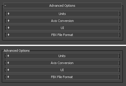

This option lets you set whether a group is expandable or not.
