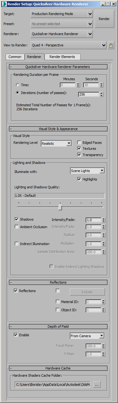

"Rendering Duration per Frame" group of controls
Properties:
<Quicksilver_Hardware_Renderer>.RenderingMode     Name    default: #iterations   --  enum
Get/set the state of the Rendering Mode radio buttons.
Possible values are:
#time - the Per-Frame Duration in seconds will be controlled by the .RenderingTime value.
#iterations (default) - the number of iterations specified by the .RenderingIterations property will be performed, resulting in variable Per-Frame Duration depending on the complexity of each frame.
Available in 3ds Max 2012 and higher.
<Quicksilver_Hardware_Renderer>.RenderingTime     Integer    default: 10   --  integer
Get/set the rendering duration in seconds.
This value will be used when the .RenderingMode is set to #time .
Valid range is from 1 to 3540, default value is 10.
Note:
Note that the User Interface exposes this value as two spinners - Minutes and Seconds.
The Seconds spinner cannot be set to 0 to avoid the entering of 0 Minutes 0 Seconds.
Thus setting the .RenderingTime value to 120 via MAXScript will result in 2 Minutes and 1 Second and not 2 Minutes 0 Seconds, and the internal value will be stored as121 seconds!
<Quicksilver_Hardware_Renderer>.RenderingIterations     Integer    default: 256   --  integer
Get/set the number of iterations to perform when the .RenderingMode property is set to #iterations
This is the number of iterative refinement steps performed by the Nitrous Graphics system introduced in 3ds Max 2012.
Min. value is 1, Max. value is 4096, Default is 256.
"Visual Style" group of controls
Similar properties and methods are exposed by the NitrousGraphicsManager Interface for controlling the viewport Visual Style.
Properties:
<Quicksilver_Hardware_Renderer>.VisualStyle     Name    default: #Realistic   --  enum
VisualStyle enums: { #Realistic | #Shaded | #ConsistentColors | #HiddenLine | #Wireframe | #Clay | #BoundingBox | #Ink | #ColorInk | #Acrylic | #Tech | #Graphite | #ColorPencil | #Pastel }
Get/set the rendering visual style.
<Quicksilver_Hardware_Renderer>.EdgedFaces     BooleanClass    default: false   --  bool
Get/set the state of the Edged Faces checkbox.
<Quicksilver_Hardware_Renderer>.TextureEnabled     BooleanClass    default: true   --  bool
Get/set the state of the "Textures" checkbox.
When set to true (default), textures will be rendered.
When set to false, textures will be ignored.
<Quicksilver_Hardware_Renderer>.TransparencyEnabled     BooleanClass    default: true   --  bool
Enable/Disable the calculation of transparency.
Default value is false.

"Lighting" group of controls
Properties:
<Quicksilver_Hardware_Renderer>.UseDefaultLights     BooleanClass    default: false   --  bool
Get/set whether to use the Default Lights (True) or the Scene lights (False).
<Quicksilver_Hardware_Renderer>.Highlights     BooleanClass    default: true   --  bool
Get/set whether to render with Highlights (True, Default) or without Highlights (False).
Available in 3ds Max 2013 and higher.
<Quicksilver_Hardware_Renderer>.IndirectIlluminationEnabled     BooleanClass    default: false   --  bool
Enable/Disable Indirect Illumination calculations.
Default value is False.
<Quicksilver_Hardware_Renderer>.IndirectIlluminationMultiplier     Float    default: 1.0   --  float
Get/set the Indirect Illumination Multiplier value.
Valid values are between 0.0 and 3.0
Default value is 1.0.
<Quicksilver_Hardware_Renderer>.IndirectIlluminationSampleArea     Float    default: 100.0   --  float
Get/set the Indirect Illumination Sample area value.
<Quicksilver_Hardware_Renderer>.IndirectIlluminationLODEnabled     BooleanClass    default: false   --  bool
Get/set the state of the Indirect Illumination Level Of Detail option.
<Quicksilver_Hardware_Renderer>.IndirectIlluminationShadowEnabled     BooleanClass    default: false   --  bool
Enable/Disable Indirect Illumination Shadows.
<Quicksilver_Hardware_Renderer>.IndirectIlluminationShadowRange     Integer    default: 8   --  integer
Get/set the Indirect Illumination Shadow Range value.
Valid values are between 1 and 32.
Default value is 8.
<Quicksilver_Hardware_Renderer>.IndirectIlluminationShadowSize     Integer    default: 256   --  integer
Get/set the Indirect Illumination Shadow Size value.
Valid values are between 32 and 2048.
Default value is 256.
<Quicksilver_Hardware_Renderer>.IndirectIlluminationRSMSize     Integer    default: 256   --  integer
Get/set the Indirect Illumination RSM Size value.
"Shadows" group of controls
Properties:
<Quicksilver_Hardware_Renderer>.UseShadows     BooleanClass    default: true   --  bool
Get/set whether to use shadows.
Default value is true.
<Quicksilver_Hardware_Renderer>.SoftShadowMultiplier     Float    default: 1.0   --  float
Get/set the Soft Shadows Multiplier value.
Valid values are:
0.0 - Point Lights / Hard Shadows
0.125 - Very Low
0.25 - Low
0.5 - Medium
1.0 - Default
2.0 - High Quality
4.0 - High Quality
8.0 - High Quality
16.0 - Very High Quality
Any other values will be ignored.
<Quicksilver_Hardware_Renderer>.ShadowIntensity     Float    default: 1.0   --  float
Get/set the Shadow Intensity/Fade value.
Valid range is 0.0 to 1.0.
<Quicksilver_Hardware_Renderer>.AmbientOcclusionEnabled     BooleanClass    default: false   --  bool
Enable/Disable Ambient Occlusion.
<Quicksilver_Hardware_Renderer>.AmbientOcclusionIntensity     Float    default: 1.0   --  float
Get/set the Ambient Occlusion Intensity/Fade value.
Valid range is 0.0 to 2.0.
<Quicksilver_Hardware_Renderer>.AmbientOcclusionRadius     Float    default: 3.0   --  float
Get/set the Ambient Occlusion Radius value.
Valid range is 0.0 to 200.0.

"Reflections" group of controls
Properties:
<Quicksilver_Hardware_Renderer>.ReflectionsEnabled     BooleanClass    default: true   --  bool
Enable/Disable the calculation of reflections.
"Depth Of Field" group of controls
Properties:
<Quicksilver_Hardware_Renderer>.DepthOfFieldEnabled     BooleanClass    default: true   --  bool
Enable/Disable Depth Of Field calculations.
<Quicksilver_Hardware_Renderer>.DepthOfFieldMode     Name    default: #camera   --  enum
Get/set the Depth Of Field mode.
#Camera - (default) -uses the Camera's Depth Of Field settings.
#Override - uses the renderer's Override settings (NearPlane, FarPlane, FocalPlane).
<Quicksilver_Hardware_Renderer>.FocalPlane     Float    default: 100.0   --  float
Get/set the Override Depth Of Field Focal Plane value.
Default is 100.0.
Used only when .DepthOfFieldMode is set to #Override .
<Quicksilver_Hardware_Renderer>.fStop     Float    default: 1.0   --  float
Get/set the Depth Of Field fStop value.
<Quicksilver_Hardware_Renderer>.BokehShape     String    default: ""   --  filename
Get/set the Bokeh shape control bitmap.
When set to empty string "" (default), the Depth Of Field effect will create a disk-shaped circle of confusion.
When set to a valid bitmap file with RGB and Alpha channel, the Alpha channel will define the shape of the Bokeh effect.
Not exposed to the UI.
"Hardware Shaders Cache Folder" group of controls
Properties:
<Quicksilver_Hardware_Renderer>.UseShaderCacheFileSystem     BooleanClass    default: true   --  bool
Enable/disable the use of the Hardware Shaders Cache File system.
Methods:
<void><Quicksilver_Hardware_Renderer>.ForceSaveShaderCacheFile()
Forces the saving of the Shader Cache File.
Update Render Setup Dialog
Methods:
<void><Quicksilver_Hardware_Renderer>.CommitParameters()
Commits all changes to the Renderer's UI.
<void><Quicksilver_Hardware_Renderer>.UpdateUI()
Updates the Renderer's UI to reflect changes made using MAXScript.
<void><Quicksilver_Hardware_Renderer>.RunUnitTests()
For internal use only.
