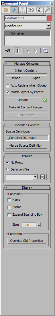

Container interfaces:
Interface:IContainerObject
Properties:
.proxyType: enum : Read|Write
proxyType enums: {#none|#alternate}
Get/set the state of the radio button controlling the use of Proxies.
Possible values are:
#none - Do not use a Proxy file.
#alternate - Use the Proxy file specified by the previous two properties.
Available in 3ds Max 2011 and higher.

<bool><Container>.LoadContainer()
Loads the Container's content from its definition and local modifications. Only available when unloaded.
Corresponds to pressing the "Load" button in the Container's UI when the Container is in Unloaded state (see .unloaded property for querying this state). The button will change to "Unload".
Returns true on success, false otherwise.
<bool><Container>.UnloadContainer()
Unloads the Container by saving the local definition and deleting the content from the scene.
Corresponds to pressing the "Unload" button in the Container's UI when the Container is in the Loaded state (see .unloaded property for querying this state). The button will change to "Load".

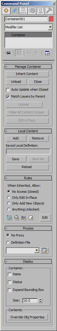

<bool><Container>.SetOpen <bool>open
When the argument is true , opens the Container, equivalent to pressing the "Open" button in the Container's UI.
When the argument is false , closes the Container, equivalent to pressing the "Close" button in the Container's UI.
<bool><Container>.IsOpen()
Returns true if the Container is open, false otherwise. See previous method for controlling the open state.

Access Type Control Methods
<void>SetAccessType <enum>accessType
accessType enums: {#noAccess|#onlyEditInPlace|#onlyAddNewObjects|#anythingUnlocked}
Sets the access type to the given enum value.
<enum>GetAccessType()
GetAccessType enums: {#noAccess|#onlyEditInPlace|#onlyAddNewObjects|#anythingUnlocked}
Returns the access type as an enum value.
<enum>InheritedAccessType()
InheritedAccessType enums: {#noAccess|#onlyEditInPlace|#onlyAddNewObjects|#anythingUnlocked}
Returns the inherited access type as an enum value.
<void>SetLockedContents<enum>lockedType <bool>clear
lockedType enums: {#lockAllMaterials|#lockAllModifiers|#lockAllAnimation|#lockAllObjects}
Sets the lock for the content component specified by the first argument's enum to the Boolean value of the second argument.
<bool>IsLockedContents <enum>lockedType
Returns true if the content component specified by the argument is locked, false if it is unlocked.
