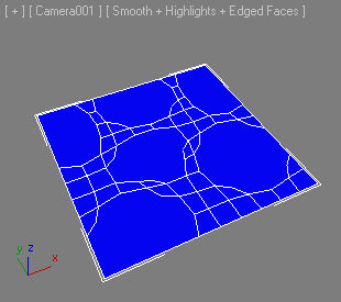

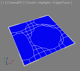

<bool>PolyToolsTopology.Skin ()
Generates a skin type topology with rounded patches.
Returns true on success, false on failure.
EXAMPLE:
--Step 1:
p = Plane widthsegs:10 lengthsegs:10 wirecolor:blue --create a plane
convertTo p Editable_Poly --convert to EPoly
select p --select the plane
max modify mode --switch to modify panel
subObjectLevel = 4 --switch to Edge level
--Step 2:
PolyToolsTopology.Skin()

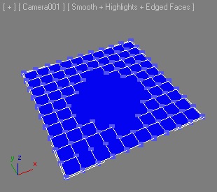

<bool>PolyToolsTopology.Holer ()
Generates "holes" in the topology. See also .Tatter() further on this page.
EXAMPLE:
--Step 1:
--Step 2:
PolyToolsTopology.Holer()

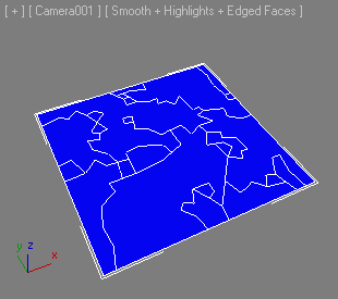

<bool>PolyToolsTopology.Chaos ()
When applied to a grid of quads, generates a chaotic topology with randomly shaped patches.
EXAMPLE:
--Step 1:
--Step 2:
PolyToolsTopology.Chaos()

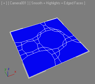

<bool>PolyToolsTopology.SmoothStar ()
When applied to a grid of quads, generates a random smoothed stars topology.
EXAMPLE:
--Step 1:
--Step 2:

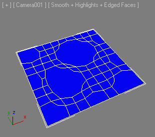

<bool>PolyToolsTopology.Cross ()
When applied to a grid of quads, generates a topology with cross-like patters.
EXAMPLE:
--Step 1:
--Step 2:
PolyToolsTopology.Cross()

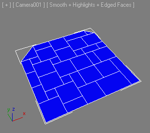

<bool>PolyToolsTopology.Planks2 ()
When applied to a grid of quads, generates a topology with broader "planks" than the .Planks1() method.
EXAMPLE:
--Step 1:
--Step 2:
PolyToolsTopology.Planks2()

<bool>PolyToolsTopology.Tatter <integer>size <integer>iterations <integer>smooth
Generates "holes" in the topology, separated by rows of polygons.
The first argument determines the overall size of the generated holes.
The second argument determines the number of different sizes for the generated holes.
The third argument determines how rounded the generated holes will be.
EXAMPLES:
--Step 1:
--Step 2:
PolyToolsTopology.Tatter 1 1 1
--Step 1:
--Step 2:
PolyToolsTopology.Tatter 2 1 1
-- Step 1:
--Step 2:
PolyToolsTopology.Tatter 3 1 1
--Step 1:
--Step 2:
PolyToolsTopology.Tatter 1 2 1
--Step 1:
--Step 2:
PolyToolsTopology.Tatter 1 10 1
Back To Topic Navigation
<bool>PolyToolsTopology.ScrapVerts ()
Removes vertices shared by only two edges.
EXAMPLE:
--Step 1:
subObjectLevel = 1 --switch to Edge level
PolyOp.SetEdgeSelection p #{105} --select one central edge
for i = 1 to 3 do p.GrowSelection selLevel:#edge --and grow the selection
p.Remove selLevel:#Edge --then remove the selected edges
PolyOp.SetEdgeSelection p #{5,8,11} --select a portion of a loop
p.Remove selLevel:#Edge --and remove it, while leaving some stray vertices
--Step 2:
