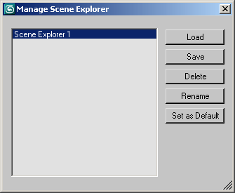

Scene Explorer Manager
<void>SceneExplorerManager.OpenManageInstancesDialog()
Opens the "Manage Scene Explorer" dialog.
<void>SceneExplorerManager.CloseManageInstancesDialog()
Closes the "Manage Scene Explorer" dialog.
<boolean>SceneExplorerManager.LoadExplorerConfiguration <&String>configurationFile
configurationFile is In parameter
Loads a previously saved Scene Explorer configuration from the specified configuration file.
Corresponds to pressing the "Load" button in the "Manage Scene Explorer" dialog and selecting the file to load.
Returns True on success, False otherwise.
<boolean>SceneExplorerManager.SaveExplorerConfiguration <&String>explorerName <&String>outputConfigurationFile
explorerName is In parameter
outputConfigurationFile is In parameter
Saves the configuration of the named Scene Explorer to the configuration file specified by the second argument.
Corresponds to pressing the "Save" button in the "Manage Scene Explorer" dialog with the named Scene Explorer selected and specifying the file to save to.
<boolean> SceneExplorerManager.DeleteExplorer <&String>explorerName
Deletes the Scene Explorer with the given name.
Corresponds to pressing the "Delete" button in the "Manage Scene Explorer" dialog with the named Scene Explorer selected.
<boolean>SceneExplorerManager.RenameExplorer <&String>oldExplorerName <&String>newExplorerName
oldExplorerName is In parameter
newExplorerName is In parameter
Renames the Scene Explorer with the name specified by the first argument to the name given by the second argument.
Corresponds to pressing the "Rename" button in the "Manage Scene Explorer" dialog with the named Scene Explorer selected and entering a new name.

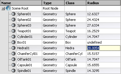

EXAMPLE USAGE:
--Define a getter function which returns the radius property
--if it exists or implicitly undefined when no such property
fn getRad theNode = (
if isProperty theNode "Radius" then theNode.Radius )
--Define asetter function which sets the radius property
--if it exists otherwise does nothing
fn setRad theNode theValue = (
if isProperty theNode "Radius" then theNode.Radius = theValue)
--Add a Property filter to the Scene Explorer Manager with the name
--"Radius" and the two functions as second and third argument
SceneExplorerManager.addProperty "Radius" getRad setRad
--Define a getter function which returns the class of the node
fn getClass theNode = (classof theNode)
--Add aRead-OnlyProperty filter to the Scene Explorer Manager
--which can only get properties but cannot set them
SceneExplorerManager.addReadOnlyProperty "Class" getClass
Once evaluated, the new properties will appear at the end of the Column Chooser dialog:
Drag the new columns to a Scene Explorer to see the class of all scene nodes and the radius value of any scene node that has a .radius property:
To make these additional properties available to the Scene Explorer in future 3ds Max sessions, save the custom property filter definitions to a script file in the Scripts\Startup folder.
