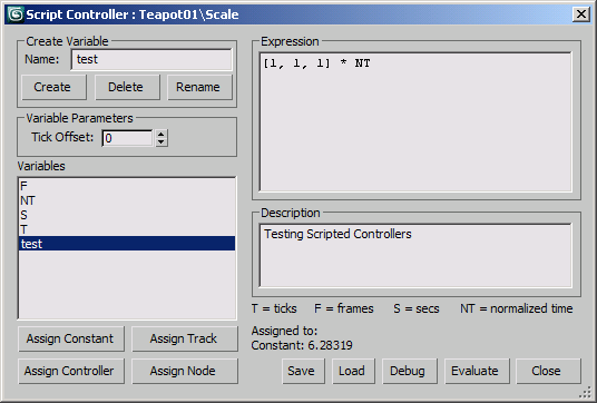

User-Defined Variables
A script controller supports four types of user-defined variables: Constant, Target, Object, and Node. The main difference between these variables is the type of value or reference they contain, which in turn determines the type of notification messages that will cause an update of the script controller.
Note that in the Script Controller UI, the creation of the variable and the assignment of the value is performed in two separate steps (the Create button always creates a Constant Variable with a value of 0) while in MAXScript, the creation and assignment are performed in a single step.

obj.scale.controller.addConstant "test" (pi*2)
-->true
obj.scale.controller.getValue"test"
-->6.28319
obj.scale.controller.getValue"test2"
-- Runtime error: IScriptCtrl::GetVarValue - Bad Index or name: "test2"

obj = Teapot()--Create a teapot
-->$Teapot:Teapot001 @ [0.000000,0.000000,0.000000]
obj.scale.controller = scale_script ()--Add a Scale Script Controller
-->Controller:Scale_Script
obj.scale.controller.numVariables ()--Default Variables Count
-->4
obj.scale.controller.addConstant "test" (pi*2)--Add a Variable
-->true
obj.scale.controller.variableExists "test"--See if it exists
-->true
obj.scale.controller.variableExists "someValue" --This one does not
-->false
obj.scale.controller.GetType "test" --Check Variable Type
-->#constant
obj.scale.controller.numVariables ()--Check Variable Count
-->5
obj.scale.controller.getIndex "test" --Get the variable's index
-->5
obj.scale.controller.getName 5--Get the 5th variable's name
-->"test"
sliderTime = 1f--Set the current scene time to frame 1
-->1f
obj.scale.controller.getValue 1--Time in Ticks
-->160.0
obj.scale.controller.getValue"T"--Time in Ticksaccessed by Name
-->160.0
obj.scale.controller.getValue 2--Time in Seconds
-->0.0333333
obj.scale.controller.getValue"S"--Time in Secondsaccessed by Name
-->0.0333333
obj.scale.controller.getValue 3--Time in Frames
-->1.0
obj.scale.controller.getValue"F"--Time in Framesaccessed by Name
-->1.0
obj.scale.controller.getValue 4--Normalized Time in Range 0-100
-->0.01
obj.scale.controller.getValue"NT"--Normalized Timeby Name
-->0.01
obj.scale.controller.getValue 5--User Constant Variable
-->6.28319
obj.scale.controller.getValue"test"--User Constant by Name
-->6.28319
obj.scale.controller.getValue"sunPos"--User Constant by Name
-- Runtime error: IScriptCtrl::GetVarValue - Bad Index or name: "sunPos"
obj.scale.controller.renameVariable"test" "someValue"--Rename...
-->true
obj.scale.controller.getValue"someValue"--User Constant by New Name
-->6.28319
