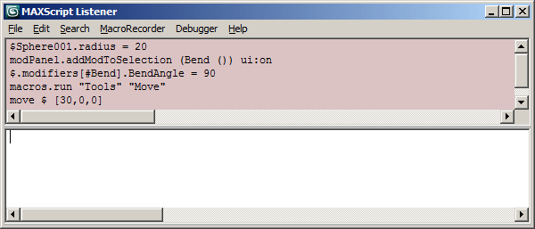

The MAXScript Macro Recorder captures many of the actions performed by the user, and generates the MAXScript commands that correspond to those actions.
Output from Macro Recorder is displayed in the pink Macro Recorder pane of the MAXScript Listener window:

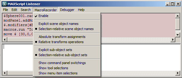

MacroRecorder Listener Menu
Several filtering options are available that control what types of user actions are recorded, whether the generated MAXScript commands contain explicit object references or are selection-relative, and whether the generated MAXScript commands contain explicit or relative transforms and coordinates.
These options are set using the MacroRecorder menu in the Listener window:

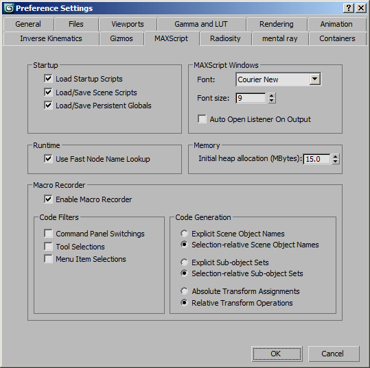

Macro Recorder Preferences
The default option settings are specified in the MAXScript page of the 3ds Max Preferences dialog, as described in the MAXScript Preferences Settings topic in the 3ds Max User Reference.
These settings can also be changed or set by editing the [MAXScript] section of the 3dsmax.ini file.

The following Macro Recorder menu commands are available in the Listener:
Enable
When Enable is selected the Macro Recorder will generate MAXScript commands.
Explicit Scene Object Names/Selection-Relative Scene Object Names
Specifies whether to use explicit scene object names or the selection set token in the generated commands if only one object is selected.
If more than one object is selected, the selection set token is always used.
FOR EXAMPLE,
if Explicit Scene Object Names is enabled, a typical generated command would be:
move $Sphere03 [55.6739,23.5,0]
If Selection-Relative Scene Object Names is enabled, a typical generated command would be:
move $ [0,-47.8044,0]
By using Selection-Relative Scene Object Names, you can apply the recorded script to a different selection, thereby making it somewhat general.
Use Explicit Scene Object Names if you want the script to always work on the same objects regardless of the current scene selection.
