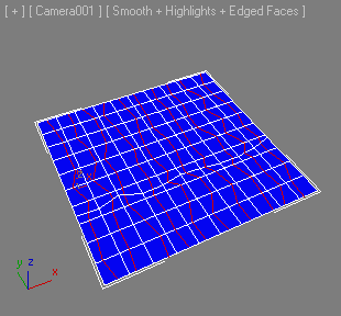

EXAMPLE
Random Connecting Within a 10x10 Grid using autoLoop passed as true:
--Step 1:
p = plane lengthsegs:10 widthsegs:10 wirecolor:blue --create a plane
convertTo p Editable_Poly --convert the plane to Editable_Poly
select p --select the plane to be able to see the results
max modify mode --switch Command Panel to Modify mode
subObjectLevel =2 --switch to polygonsub-object level
polyOp.setEdgeSelection p #{82} --select one edge to define a loop
--Step 2:
PolyToolsModeling.RandomConnect 0.3 true --create loops and connect randomly
Note that although there was just a single edge selected, the AutoLoop second argument set to true produced an edge ring from the selected edge, then performed the random connect over the new selection. With autoLoop false, no connection edges are created.
--Step 3:
--Step 4:
In the third step, we start once again from a single edge loop which, if used with autoLoop set to false, would not produce any connections. Now we produce a large number of parallel random loops, but they are "blocked" by unselected straight edgeloops which would once again produce no connections if autoLoop would be passed as false in the fourth step.

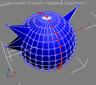

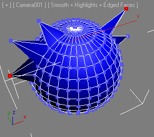

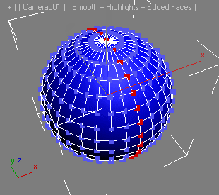

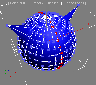

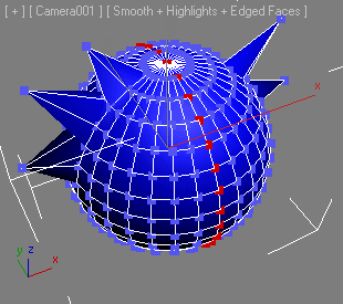

<bool>PolyToolsModeling.CurveLoop <bool>autoLoop <bool>spaceLoop
Adjusts each set of selected edges/edgeloops into smooth curves.
The curvature of each loop is determined by the position of the selected vertices along the loop. Think of the curve that you can create as a spline going from the endpoints of the edges/loop with a smoothly interpolated spline knot at each selected vertex.
If the autoLoop argument is true , the initial selection will be automatically looped before the tool is applied.
If the spaceLoop argument is true , all vertices will be evenly spaced along the loop.
If the spaceLoop argument is false , the initial relationship between vertices on the loop will be kept.
Note:
The edgeloop selection must not be closed (like a circle) for this tool to work because there needs to be a start and end-point for a curve.
The actual edgeloop can be closed, but not the selected edgeloop.

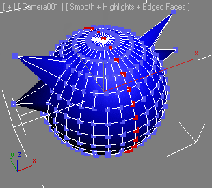

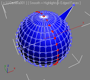

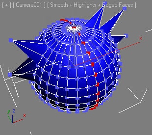

Symmetry
<bool>PolyToolsModeling.SymmetryGather <node>node <value>axis <float>threshold
Collects symmetry data from the node specified as the first argument.
The second argument defines the symmetry axis as name- #x, #y, or #z.
The third argument defines the position variation threshold to use when searching for symmetry vertices.
<bool>PolyToolsModeling.SymmetryPosToNeg <value>axis
Copies the vertex positions from the positive side of the symmetry axis to the negative side.
The axis argument can be either #x, #y, or #z.
Corresponds to the "+To-" button in the Symmetry Tools floating dialog.
<bool>PolyToolsModeling.SymmetryNegToPos <value>axis
Copies the vertex positions from the negative side of the symmetry axis to the positive side.
Corresponds to the "-To+" button in the Symmetry Tools floating dialog.
<bool>PolyToolsModeling.SymmetryFlip <value>axis
Swaps the symmetry data about the specified axis.
<bool>PolyToolsModeling.SymmetryCopy ()
Copies the vertex positions of the currently selected vertices into an internal "clipboard".
<bool>PolyToolsModeling.SymmetryPaste ()
Pastes the vertex positions back onto the same vertices, even if not selected.
EXAMPLES
Using the Symmetry methods:
--Step 1:
s = sphere radius:12 segs:32 wirecolor:blue
convertTo s Editable_Poly
select s
max modify mode
subObjectLevel = 1
PolyToolsModeling.SymmetryGather s #x 0.01
--Step 2:
PolyOp.moveVert s #{122} [5,0,5]
--Step 3:
PolyToolsModeling.SymmetryPosToNeg #x
--Step 4:
PolyOp.moveVert s # {170} [-5,0,0]
--Step 5:
PolyToolsModeling.SymmetryNegToPos #x
--Step 6:
PolyOp.moveVert s #{58} [3,0,5]
--Step 7:
PolyToolsModeling.SymmetryFlip #x
--Step 8:
PolyOp.setVertSelection s #{122,170}
PolyToolsModeling.SymmetryCopy()
PolyOp.moveVert s #{122,170} [5,0,-20]
--Step 9:
PolyToolsModeling.SymmetryPaste()
