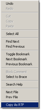

This is the default context menu which appears when you right-click in the Editor window:

Adding a new user-defined keyboard shortcut
Let’s assume you want to add a menu item for the editor feature "Copy As RTF". This feature is already listed in the Edit menu but could be placed closer to the mouse for easier copying of formatted colored text between the Editor and external word processing applications.
user.context.menu=\
Next File |IDM_PREVFILE|\
Prev File|IDM_NEXTFILE|\
Copy As RTF|IDM_COPYASRTF|
