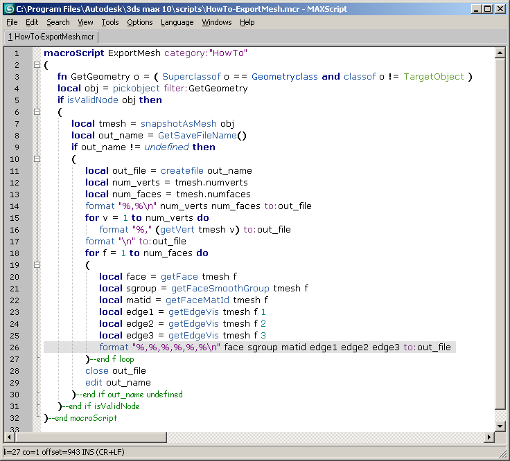

MAXScript opens the selected script in a tab inside the modeless MAXScript Editor window:
The MAXScript Editor is suited for developing longer scripts or code fragments you want to keep. You can edit and test parts of them until they are complete, then save your code in a script file for later use. This is a common method for developing large scripts, utilities, and function libraries.

You can open a MAXScript Editor tab from within the Listener or from other running scripts by calling the edit() method. The syntax for the edit() method is:
edit <filename_string>
where <filename_string> is a string literal or an expression that evaluates to a string, and specifies the name of the file whose contents are to be loaded into the new MAXScript Editor window.
EXAMPLE
edit "my_script.ms"
or
scriptfile="my_script.ms"
edit scriptfile
