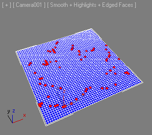

Selection - By Random
<bool>PolyToolsSelect.Random <float>percent <integer>number <integer>type <bool>withinSel
Selects random sub-object elements by percentage or absolute count.
The first argument is the percentage in the range of 0.0 to 100.0. It is used only when the third argument is set to 1.
The second argument is the absolute sub-object count to select. It is used only when the third argument is set to 0.
The third argument determines the selection mode: 0 = use absolute count and 1 = use percentage.
The fourth argument determines whether to select within all sub-objects or only the selected ones:

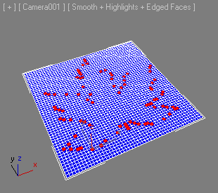

ShiftPressed = True
Polygon
Select random polygons.
Select random polygons only within the current selection.
Edge
Select random edges.
Select random edges only within the current selection.
Vertex
Select random vertices.
Select random vertices only within the current selection.
EXAMPLE:
thePlane = Plane widthsegs:20 lengthsegs:20 --create a plane
convertTo thePlane Editable_Poly --convert to EPoly
select thePlane --select the plane
max modify mode --switch to modify panel
subObjectLevel = 4 --switch to Polygon level
PolyToolsSelect.Random 0.0 20 0 false --select 20 randompolygons
subObjectLevel = 2 --switch toEdgelevel
PolyToolsSelect.Random 50.0 0 1 false --select50% of the edges

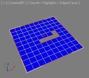

<bool>PolyToolsSelect.NumericEdge <bool>withinSel
Selects edges that have only one adjacent polygon ("open edges").
The first argument controls whether only edges within the current edge selection must be tested (true) or whether all edges in the object must be used (false).
EXAMPLE:
p = Plane widthsegs:10 lengthsegs:10 wirecolor:blue --create a plane
convertTo p Editable_Poly --convert to EPoly
select p --select the plane
PolyOp.deleteFaces p #{45..48,58} --delete some faces to add open edges
PolyToolsSelect.NumericEdge false --select open edges

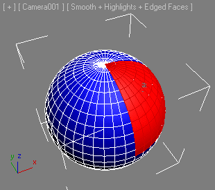

Selection - By Half

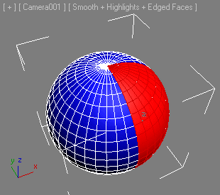

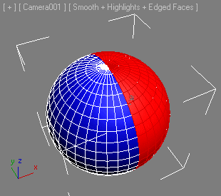

<bool>PolyToolsSelect.Half <integer>axis <bool>invert <bool>withinSel
Selects half of the sub-object elements at the current Sub-Object Level.
The first argument specifies the axis as follows:
1 - X
2 - Y
3 - Z
The second argument controls whether the positive side of the object (true) or the negative side of the object (false) will be selected.
The third argument controls whether to use the whole object (false) or only the current selection (true).
EXAMPLE:
--Step 1:
s = sphere radius:12 segs:40 wirecolor:blue
convertTo s Editable_Poly --convert to EPoly
select s --select the sphere
subObjectLevel = 4 --switch to facelevel
--Step 2: Select positive (right) side along X using all faces
PolyToolsSelect.Half 1 true false
--Step 3: Select negative (front) side along Y using the existing selection
PolyToolsSelect.Half 2 false true
--Step 4:Select positive (top) side along Z using the existing selection
PolyToolsSelect.Half 3 true true

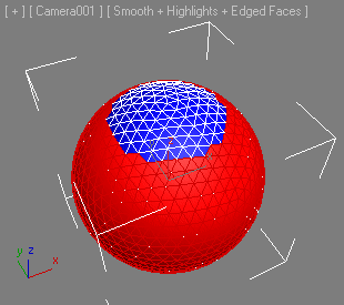

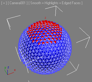

Selection - By Normal
<bool>PolyToolsSelect.Normal <integer>axis <float>value <bool>invert
Selects sub-object elements in the current Sub-Object Level based on normal vector.
The first argument defines the reference world axis as follows:
1 - World X
2 - World Y
3 - World Z
The second argument defines the angle threshold. Sub-objects with normals that define an angle with the reference world axis that is less than the threshold will be selected.
The third argument defines whether to select the sub-objects whose normals are below the threshold (false) or the ones whose normals are above the threshold (true).
EXAMPLE:
--Step 1:
s = geosphere radius:12 segs:10 wirecolor:blue pos:[0,0,-5]
select s--select the geosphere
subObjectLevel = 1 --switch to Vertex level
PolyToolsSelect.Normal 3 15 false --select vertices within 15 degrees to +Z
--Step2:
subObjectLevel = 2 --switch to Edge level
PolyToolsSelect.Normal 3 15 false --selectedgeswithin 15 degrees to +Z
--Step3:
subObjectLevel = 4 --switch to Face level
PolyToolsSelect.Normal 3 15 false --select faces within 15 degrees to +Z
--Step4:
PolyToolsSelect.Normal 3 15 true --selectfaces outside of15 degrees to +Z

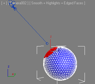

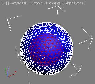

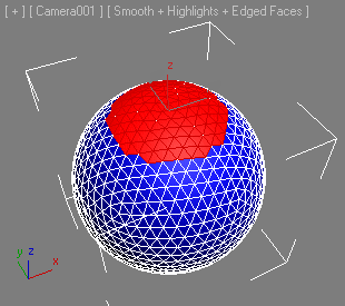

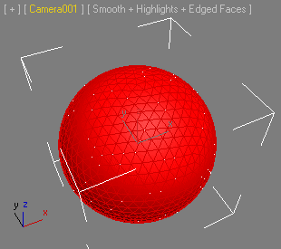

Selection - By Perspective

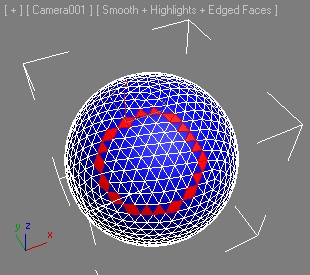

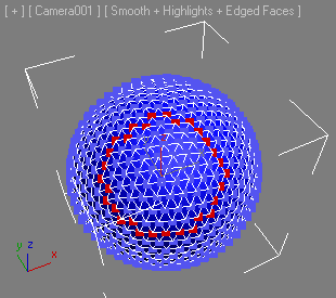

<bool>PolyToolsSelect.Perspective <float>value <bool>outline
Selects sub-object elements at the current Sub-Object Level whose normals are within the given threshold to the current view's Z axis.
The first argument defines the angle threshold.
The second argument controls whether all sub-objects within the Threshold must be selected (false) or only the ones adjacent to the outline of the selection (true).
EXAMPLE:
--Step 1:
select s --select the geosphere
PolyToolsSelect.Perspective 30 false
--Step 2:
PolyToolsSelect.Perspective 30 true
--Step 3:
--Step 4:
--Step 5:
--Step 6:

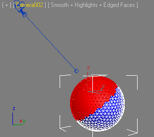

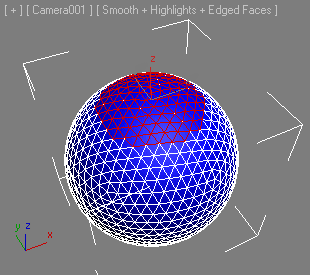

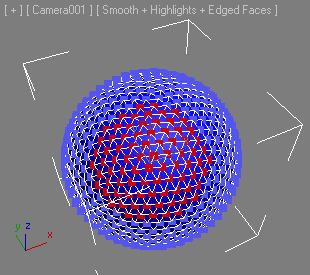

Selection - Grow From Perspective View

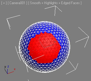

<bool>PolyToolsSelect.PerspectiveGrow <float>value
Grows the sub-selection in the current view space by assuming the closest sub-object element to the viewer's position as 0 and growing the selection away from the viewer in world units.
EXAMPLE:
--Step 1:
PolyToolsSelect.PerspectiveGrow 2
--Step 2:
PolyToolsSelect.PerspectiveGrow 12
Because the Radius of the Geosphere is 12 units, selecting with a value of 12 selects approximately half of the sphere in the current view (Camera001 - left image).

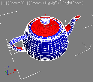

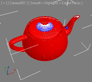

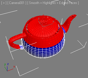

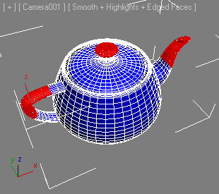

Selection - By Pivot Distance
<bool>PolyToolsSelect.Distance <float>value
Selects sub-objects in the current level based on a percentage of the largest distance to the pivot point of the object.
The percentage is provided by the first argument.
Returns true on success, false on failure. For example, if not in a valid sub-object mode.
EXAMPLE:
--Step 1:
t = teapot radius:10 segs:10 wirecolor:blue
convertTo t Editable_Poly --convert to EPoly
select t --select the teapot
PolyToolsSelect.Distance 70.0 --and select using 70%
--Step2:
PolyToolsSelect.Distance 60.0 -- select using60%
--Step 3:
s.pivot = [0,0,5] --move pivot up by half the radius
resetxform s --reset XForm
collapseStack s --and collapse the stack
subObjectLevel = 4 --switch toFacelevel
PolyToolsSelect.Distance 70.0 --and select again using 70%
--Step 4:

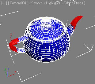

Selection - By Surface

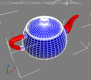

<bool>PolyToolsSelect.ConvexConcave <float>value <integer>isConcave
Selects sub-objects in the current Sub-Object Level based on a convexity/concavity threshold.
The first argument is the threshold value.
The second argument is the index of the Concave/Convex flyout in the UI as follows:
1 - Concave
2 - Convex
EXAMPLE:
--Step 1:
select t --select theteapot
subObjectLevel = 4 --switch to Facelevel
PolyToolsSelect.ConvexConcave 0.05 1 --Select Concave Faces
--Step 2:
PolyToolsSelect.ConvexConcave 0.001 2 --Select Convex Faces

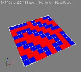

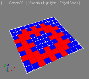

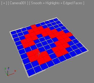

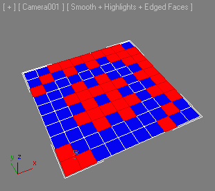

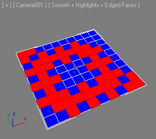

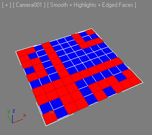

Selection - Patterns
<bool>PolyToolsSelect.Pattern1 <integer>times
Applies Selection Pattern 1 for the specified number of times.
EXAMPLE:
--Step 1:
PolyOp.SetFaceSelection p #{45} --select a central face
--Step 2:
PolyToolsSelect.Pattern1 1
--Step 3:
--Step 4:
--Step 5:
--Step 6:
Note that you can achieve the look seen on the above right screenshot by calling
PolyToolsSelect.Pattern1 5
right after evaluating Step 1 to perform the iterations internally.

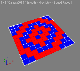

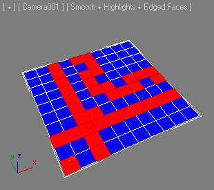

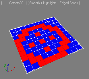

<bool>PolyToolsSelect.Pattern2 <integer>times
Applies Selection Pattern 2 for the specified number of times.
EXAMPLE:
--Step 1:
--Step 2:
PolyToolsSelect.Pattern2 1
--Step 3:
--Step 4:
--Step 5:
--Step 6:

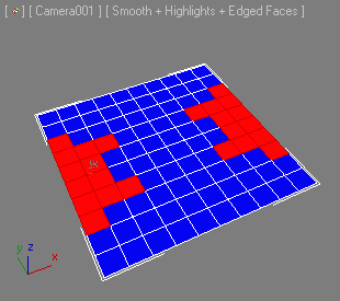

<bool>PolyToolsSelect.Pattern3 <integer>times
Applies Selection Pattern 3 the specified number of times.
EXAMPLE:
--Step 1:
--Step 2:
PolyToolsSelect.Pattern3 1
--Step 3:
--Step 4:

EXAMPLE:
--Step 1:
--Step 2:
PolyToolsSelect.Pattern5 1
--Step 3:
--Step 4:
--Step 5:
--Step 6:
--Step 7:
--Step 8:
<bool>PolyToolsSelect.Pattern6 <integer>times
Applies Selection Pattern 6 for the specified number of times.
EXAMPLE:
--Step 1:
--Step 2:
PolyToolsSelect.Pattern6 1
--Step 3:
--Step 4:
--Step 5:
--Step 6:
--Step 7:
--Step 8:

<bool>PolyToolsSelect.PatternDots <integer>times
Applies Selection Pattern Dots for the specified number of times.
EXAMPLE:
--Step 1:
--Step 2:
PolyToolsSelect.PatternDots 1
--Step 3:
--Step 4:
--Step 5:
--Step 6:
<bool>PolyToolsSelect.PatternChecker <integer>times
Applies Selection Pattern Checker for the specified number of times.
EXAMPLE:
--Step 1:
--Step 2:
PolyToolsSelect.PatternChecker 1
--Step 3:
--Step 4:
--Step 5:
--Step 6:
<bool>PolyToolsSelect.PatternGrowLine <integer>times
Applies Selection Pattern Grow Line for the specified number of times.
EXAMPLE:
--Step 1:
--Step 2:
PolyToolsSelect.PatternGrowLine 1
--Step 3:
--Step 4:
--Step 5:
--Step 6:

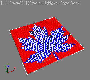

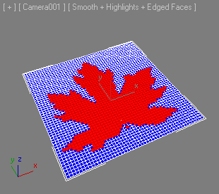

Selection - By Bitmap
<bool>PolyToolsSelect.BitmapToSel <string>file <integer>mapchannel <point3>color
Selects sub-objects in the current Sub-Object Level based on a color from a bitmap file using a given mapping channel for the bitmap application.
The first argument is the file name of the bitmap.
The second argument is the mapping channel to use for the mapping of the bitmap onto the geometry.
The third argument is the color from the bitmap to use for selecting.
Internally, the color will be compared with a built-in threshold of +/- 8.0 (256/8= 32, so the threshold is 1/32 or about 3%).
EXAMPLE:
--Step 1:
p = Plane widthsegs:50 lengthsegs:50 wirecolor:blue --create a plane
subObjectLevel = 4 --switch to Edge level
--Select faces where the bitmap color is pure white.
PolyToolsSelect.BitmapToSel "ELMLEAF.TGA" 1 white
--Step 2: Select faces where color is black.
PolyToolsSelect.BitmapToSel "ELMLEAF.TGA" 1 black
--Step 3:
PolyToolsSelect.BitmapToSel "ELMLEAF.TGA" 1 (white*0.97)
--Step 4:
PolyToolsSelect.BitmapToSel "ELMLEAF.TGA" 1 (white*0.96)
--Step 3:
PolyToolsSelect.BitmapToSel "ELMLEAF.TGA" 1 (white*0.04)
--Step 4:
PolyToolsSelect.BitmapToSel "ELMLEAF.TGA" 1 (white*0.03)
