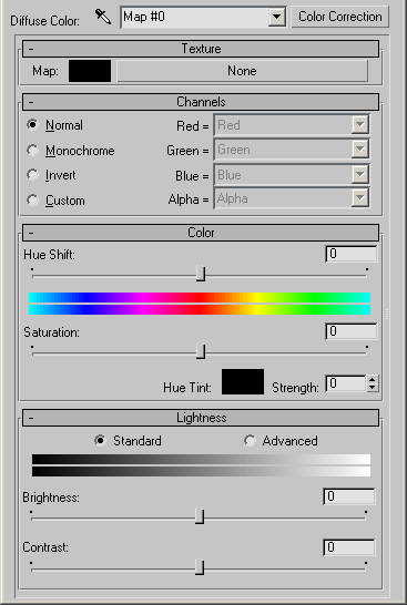

The Color_Correction TextureMap introduced in 3ds Max 2009 provides means to change the color information of an input texture map including Color Channel Rewiring,Brightness,Contrast,Hue,SaturationandExposure adjustments andmore.

Channels Rollout
Topic Navigation
<Color_Correction>.rewireR Integer default: 0 -- integer;
Get/set the Red= drop-down list index.
Possible values are:
0 - Red
1 - Green
2 - Blue
3 - Alpha
<Color_Correction>.rewireG Integer default: 1 -- integer;
Get/set the Green= drop-down list index.
0 - Red
1 - Green
2 - Blue
3 - Alpha
<Color_Correction>.rewireB Integer default: 2 -- integer;
Get/set the Blue= drop-down list index.
0 - Red
1 - Green
2 - Blue
3 - Alpha
<Color_Correction>.rewireA Integer default: 3 -- integer;
Get/set the Alpha= drop-down list index.
0 - Red
1 - Green
2 - Blue
3 - Alpha
<Color_Correction>.rewireMode Integer default: 0 -- integer; Rewire_Mode
Get/set the Rewire Mode.
0 - Normal
1 - Monochrome
2 - Invert
3 - Custom
Color Rollout
Topic Navigation
<Color_Correction>.hueShift Float default: 0.0 -- float;
Get/set the Hue Shift value.
<Color_Correction>.saturation Float default: 0.0 -- float;
Get/set the Saturation value.
<Color_Correction>.tint Color default: (color 0 0 0) -- fRGBA color; Hue_Tint;
Get/set the Hue Tint value.
<Color_Correction>.tintStrength Float default: 0.0 -- float; Hue_Strength;
Get/set the Hue Tint Strength value.
Lightness Rollout
Topic Navigation
<Color_Correction>.lightnessMode Integer default: 0 -- integer;
Get/set the Lightness Mode.
Possible values are
0 - Standard
1 - Advanced
Standard Mode Controls
Topic Navigation
<Color_Correction>.brightness Float default: 0.0 -- float;
Get/set the Brighness value in Standard mode.
<Color_Correction>.contrast Float default: 0.0 -- float;
Get/set the Contrastvalue in Standard mode.
