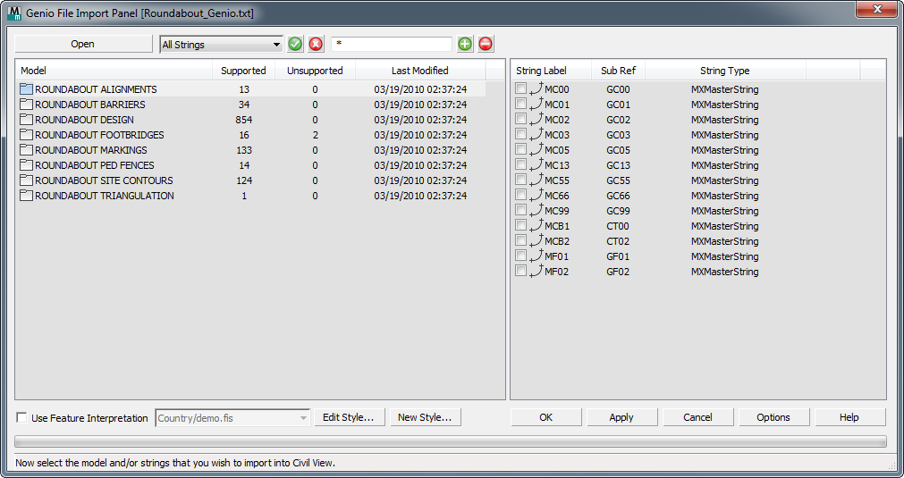

The Civil View GENIO Import Panel supports the following MX string types:
For linear MX strings, Civil View is compatible with the MX GENIO minor options 080 and 081. For triangulation strings, Civil View is compatible with MX GENIO minor options 088, 089 and 090.

This group of controls provides filtering options to help you select portions of one or more models.
[check-mark button]
[X button]You can also use the file contents list to select strings individually, or right-click the list to see a menu with additional selection options.
[plus-sign button]
[minus-sign button]Lists the strings contained in the highlighted model, by label. This list also shows the string type and number of points. For triangulation strings, the number of triangles found in each string is also displayed.
Some string labels in the list might be appear grayed out. This can happen for one of several reasons:
The string has already been imported into the current scene. Civil View automatically checks all string and model names against previously imported strings. If any identical string label and model name combination already exists in the current scene, the corresponding list item is disabled.
The string type is not supported by Civil View.
