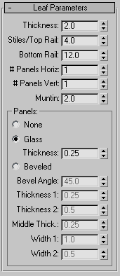

Provides controls that affect the door itself (as opposed to the door unit, which includes the frame). You can adjust the dimensions of the door, add panels, and adjust the dimensions and placement of those panels. The total number of panels for each door element is the number of horizontal divisions times the number of vertical divisions. Pivot doors have a single door element unless they are double doors. BiFold doors have two door elements, or four if they are double doors. Sliding doors have two door elements.
Sets the thickness of the door.
Sets the width of the panel framing on the top and sides. This setting is apparent only if the door is paneled.
Sets the width of the panel framing at the base of the door. This setting is apparent only if the door is paneled.
Sets the number of panel divisions along the horizontal axis.
Sets the number of panel divisions along the vertical axis.
Sets the width of the separations between the panels.
Determines how panels are created in the door.
The door has no paneling.
Creates glass panels with no beveling.
Sets the thickness of the glass panels.
Choose this to have beveled panels.
The remaining spinners affect the beveling of the panels.
Specifies the angle of the bevel between the outer surface of the door and the surface of the panel.
Sets the outer thickness of the panel.
Sets the thickness where the bevel begins.
Sets the thickness of the inner part of the panel.
Sets the width where the bevel begins.
Sets the width of the inner part of the panel.
