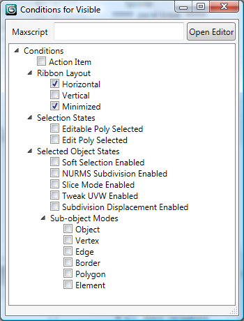

Use the Conditions dialog to set conditions for enabling ribbon elements and controls or making them visible. The full name of the dialog is Conditions For Enabled, Conditions For Visible, or Conditions for Available, depending on the Customize Ribbon dialog property from which you invoked it.
The three properties can be set to True, False, or Conditional, which returns either True or False based on the conditions. Those properties are:
If you set multiple conditions, keep in mind that when any condition for a particular state, such as the ribbon layout, is met, it causes the condition to be satisfied.
For example, the Polygon Modeling panel has two different “poly main” sub-panels available. One of the “poly main” sub-panels has its Visible property set to Conditional: Horizontal (which implies maximized) or Minimized, which applies to either horizontal or vertical.
The other sub-panel is set to Conditional: Vertical, which applies to the maximized vertical ribbon. When setting up different versions of a panel or sub-panel for different ribbon configurations, make sure the conditions for visibility don’t overlap.
However, if you set multiple conditions for different states, such as ribbon layout and active sub-object level, at least one condition in each state must be met for the condition to be satisfied.
The Conditions dialog offers a list of checkboxes for choosing preset conditions for ribbon elements; you can also custom-tailor a condition using MAXScript.
If none of the checkbox options reflects a condition you want to set, and you’re familiar with MAXScript, you can create a script to specify any conditions you like.
Enter a short MAXScript statement or function in this field to set a condition. The statement or function must evaluate to True or False (1 or 0). If True, the condition is met; if False, the condition is not met.

When you click this item, a dialog opens that lets you choose an action item to define the condition. The dialog is organized the same way as the Action Items window on the Customize Ribbon dialog. Find the command and then double-click it to apply it to the Action Item condition. The command’s name then appears in parentheses next to “Action Item” on the dialog.
Applies when the ribbon orientation is horizontal and maximized.
Applies when the ribbon orientation is vertical and maximized.
Applies when the ribbon is minimized.
Typically, if you enable either of these, enable the other as well. This is the case for the Available property in most panels on the Graphite Modeling Tools, Freeform, and Selection tabs on the ribbon.
Applies when a single editable poly object is selected and .3ds Max is in Modify mode.
Applies when a single Edit Poly object (that is, an object with the Edit Poly modifier applied) is selected and .3ds Max is in Modify mode.
Applies when Use Soft Selection on the Polygon Modeling panel is active.
Applies when Use NURMS on the Edit panel is active.
Applies when the Slice Plane tool on the Geometry (All) panel is active.
Applies when Tweak on the Edit panel is active.
Applies when Use Displacement on the Subdivision panel is active.
Applies when no sub-object level is active.
Applies at the Vertex sub-object level of editable poly and Edit Poly objects.
Applies at the Edge sub-object level of editable poly and Edit Poly objects.
Applies at the Border sub-object level of editable poly and Edit Poly objects.
Applies at the Polygon sub-object level of editable poly and Edit Poly objects.
Applies at the Element sub-object level of editable poly and Edit Poly objects.
