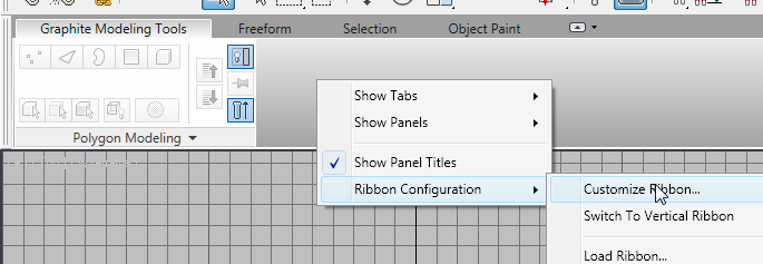

Example: To customize the ribbon, part 1:
The Customize Ribbon dialog provides a wide variety of tools for modifying the ribbon and creating new interface elements to suit your workflow precisely. This two-part procedure demonstrates some techniques you might find useful in doing so.
Customize Ribbon.
The Customize Ribbon dialog opens.

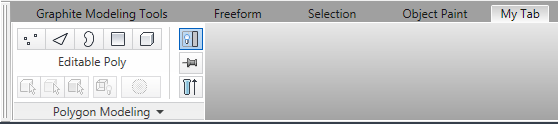

A new item named “New Tab” appears at the end of the list. Also, a tab with the same name has been added to the ribbon.
The Title property is defined as New Tab. This is the default name given to new tabs.
The new ribbon tab is now named “My Tab.”
A copy of the Polygon Modeling panel item appears as a child of My Tab item. You can confirm the copy by clicking the My Tab tab on the ribbon. You’ve just populated your tab!
This level of the hierarchy contains two sub-panels separated by a panel break. (A sub-panel, which uses the
icon, is a section of a panel that usually contains related tools.) The first sub-panel, named [C: poly main H,M], contains the visible part of the panel. The second sub-panel, after the panel break, contains the expansion that opens when you click the panel title on the ribbon.
In this naming convention, the C stands for “conditional” and the H, V and/or M show the conditions: horizontal or vertical (ribbon orientation) and/or minimized. The naming convention can also reflect other conditions such as the current sub-object level.

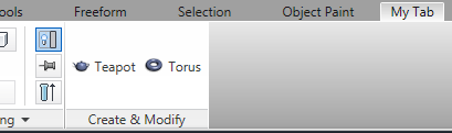

A new panel with the default name New Panel appears in the list and on the ribbon.
The list changes to show all available object primitives.
The Teapot command appears in the list and on the new panel in the ribbon. The name “Teapot” appears in the list, but not on the ribbon. However, the default icon appears in both places. You can change the image, if you like, with the Icon property; this procedure doesn’t cover the details.
Now the name “Teapot” appears next to the icon. The ribbon button has widened to fit both the icon and the label.
The two buttons sit side by side on the panel, which widens to fit. But what if you want them to be arrayed vertically?
