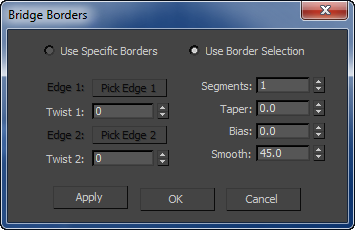

Bridging uses the caddy interface when Enable Caddy Controls is on; when off, the standard settings dialog is used. For details on using the caddy controls, see The Caddy Interface.
Left: the caddy interface; Right: the standard dialog

Choose whether to bridge sub-objects that you choose with the caddy controls, or use an existing selection. The options are:
If you make more than two qualifying selections, Bridge connects them in increasing order of ID. For example, if you select polygon 12, 35, and 89, Bridge connects polygons 12 and 35. But if you then deselect polygon 35, Bridge then connects polygons 12 and 89.
Click each Pick button in turn, and then click a polygon or border edge in a viewport. At the Border sub-object level, clicking any edge on a border designates the entire border for bridging. Also, the edges you pick on each border are connected directly, and the remaining edges are connected in consecutive order. You can change the order of the edge correspondences with the Twist settings. Available only in Use Specific mode.
After you pick a sub-object, the small circle on the Pick button changes appearance from empty to filled in. You can change the selection at any time by clicking the Pick button again and picking a different sub-object.
