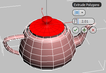

By default, most settings described in this section use the caddy, an "in-canvas” interface that comprises a dynamic label and a set of buttons superimposed on the viewport. The caddy is available when Enable Caddy Controls is on; when off, the software uses standard settings dialogs, as shown in the following illustration. Both interfaces provide identical results.

You use familiar mouse-based methods for adjusting caddy settings, including clicking and dragging spinners, drop-down lists, and keyboard entry. However, it’s important to understand the specifics of interacting with the caddy interface as detailed following:
Left: The mouse cursor is not over a control, so the caddy label shows only the feature name.
Right: The mouse cursor is over the Height control.
To reposition the caddy, drag it by the title. Thereafter it remains in the new position.
When the mouse cursor is over the control, the icon changes to a pair of arrows pointing up and down:
The arrows function the same as with the standard spinner control in 3ds Max. Drag up or down to decrease or increase the value, respectively, or click either arrow to change the value by a small increment. While dragging, right-click to restore the previous value. To increase or decrease the rate of change, Ctrl+drag or Alt+ drag, respectively. You can also right-click the arrows to reset the value to 0 or a reasonable default value, depending on the control.
When the mouse cursor is over the displayed value, it changes to a text cursor. To edit the value with the keyboard, click or double-click and then enter a new value. To finish editing and accept the new value, press Enter, or, to cancel and exit, press Esc.
