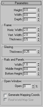

The topic for each kind of window describes its unique controls and behavior. Some window parameters are common to all kinds of windows; see Windows.
Sets the width (depth) of the rails in the sashes.
Sets the height of the middle sash, relative to the window's frame.
Sets the height of the bottom sash, relative to the window's frame.
Specifies the percent that the two movable sashes are open. This control is animatable.
