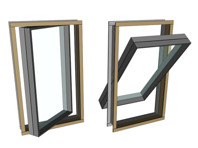

The Pivoted window has one sash only, hinged midway through the side of the sash. It can swing open either vertically or horizontally.

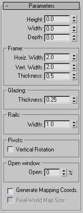

The topic for each kind of Window describes its unique controls and behavior. Most Window parameters are common to all kinds of Windows; see Windows.
Sets the width of the rails in the sash.
Switches the pivot axis from horizontal to vertical.
Specifies the percent that the window is open. This control is animatable.
