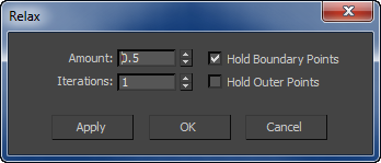

Relax uses the caddy interface when Enable Caddy Controls is on; when off, the standard settings dialog is used. For details on using the caddy controls, see The Caddy Interface.
Left: the caddy interface; Right: the standard dialog
Controls how far a vertex moves for each iteration. The value specifies a percentage of the distance from the original location of a vertex to the average location of its neighbors. Range=-1.0 to 1.0. Default=0.5.
Sets how many times to repeat the Relax process. For each iteration, average locations are recalculated and the Relax Value is reapplied to every vertex. Default=1.
Controls whether vertices at the edges of open meshes are moved. Default=on.
When on, boundary vertices do not move while the rest of the object is relaxed. This option is particularly useful when working with multiple elements within a single object that share open edges.
When this checkbox is off, all vertices of the object are relaxed.
When on, preserves the original positions of vertices farthest away from the object center.
