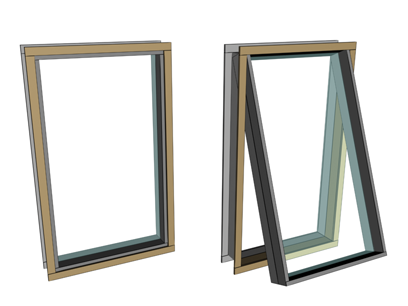

The Awning window has one or more sashes that are hinged at the top.

Sets the width (depth) of the rails in the sashes.
Sets the number of sashes in the window. If you use more than one sash, each is hinged at its top edge. Range=1 to 10.
Specifies the percent the window is open. This control is animatable.
